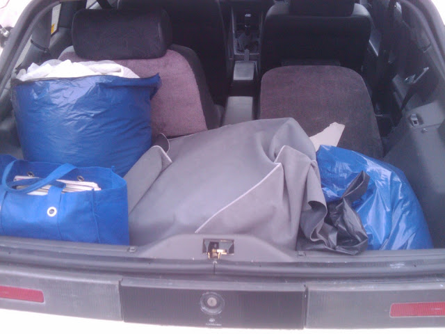

Post 313246 by daveforber on 2010-06-05 20:55:45
Boot space: Image Check the condition of the rear lights. It's the most common cause of 'damp boot' syndrome. ANY cracks in the rear lights are bad and will cause water ingress into the boot. Rear lights are also VERY expensive - rare to find used and over £150 each at the stealers. Info centre can be tempremental. My "fix" list so far on a 1995 car: * Driveshafts (both) * Wheel bearing * Brakes * Dizzy * Rear light (fortunately I found a used one) * Bumper scrapes * Heater matrix Essentially you want to check for dampness in the passenger footwell (UNDER any rubber mat!) and the boot. Plus what everyone else has said.
